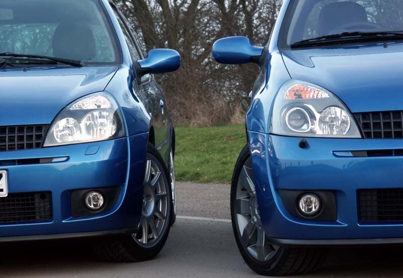

NXT on metallic blue (lefty car by machine right car by hand)
